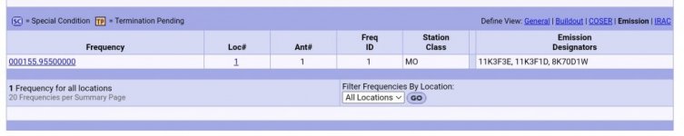

I did a check using this site: There are no P25 listings in Tennessee for that frequency
interesting site. I did get a hit on SC for that freq but the FCC license says its narrowband analog, not P25

Given that you were on I-65, that dispatch mentions Highway 31 which parallels I-65, and that an officer mentions "Merchants Bank," that likely narrows down your area of interest to Lawrence, Maury, or Williamson County. However, there are no licenses for that frequency in those counties. I know there are some VHF TACN sites, but I would expect to find a license if this frequency were to be a part of that system.

To start with, that's a repeater output, not an input. Both sides of the conversation are loud and clear, obviously a repeater.
My guess is that it's Hanceville PD in Cullman County, Alabama. The 220 NAC matches their repeater output on 155.955. U.S. Route 31 intersects with State Route 91 in Hanceville, where there is a nearby Merchant's Bank.
