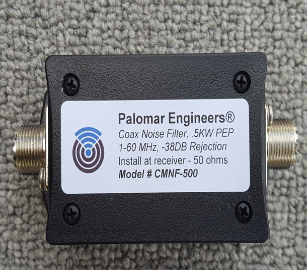

a coax filter at the transceiver
You mean an in-line, lumped component (inductors, capacitors) bandpass filter for 27 MHz / 11m? Or a "common mode filter" which is basically more ferrites around a piece of coax in a box with PL-259 connectors to remove RF currents on the shield of the coax before it goes in the radio?
I'm running some clip-on ferrites on the coax where it plugs into the 3/8x24 antenna mount outside, and a couple more clip-on ferrites on the coax on the inside of the vehicle where it plugs into the radio. Haven't bothered with an external 11m "bandpass filter", assume the Uniden 980 has enough of that internally.
slowmover
Aug 4, 2020
3,784
Fort Worth
This one at present.
This one in future
Antenna Feedpoint:
Palomar MC-1-500-50
Sirio 3/8 Trucker on 44” shaft.
18’ of coax picks up a helluva lot of noise in big truck. Didn’t realize just how much. Haven’t yet added something to the series where a margin isn’t bettered.
