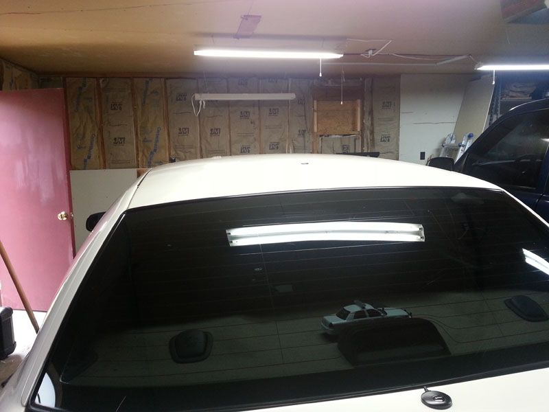

Well the cup holder slides in and out and it has my only A/C connector in the car which I use to charge my Iphone. The small shot antenna is the magnetic one. It can be removed by just picking it off. The larger antenna is semi glued on but covers a pre existing hole. I can just install the antenna into that hole. Another reason why I think i'd just be better overall to take it into would be that they can find easier way to either fill in or widen the hole if needed to make the antenna work. So pretty much buy the antenna and the mount and take it to them.
There's nothing in the travel console. I just got it as a filler for the gap between the two seats. It's loosely screwed into the flooring.

There's actually two on the roof. One with a plug and one with the antenna over it. The one with the antenna is a bit more back and to the right than the one with the plug. Just to verify there NEEDS to be metal to metal with the mount of the antenna or the the actually mount with the cord that has the SMA or BNC connector?
I'm thinking the forward hole held the lightbar cord. The one with the antenna seems too far off to the side and back to be under the lightbar.

Yes you are correct about which hole is which! I wasnt sure if you have another sealed on or not. Since you say you do, that was definitely the lightbar hole. Mine is sealed as well.
You do need metal to metal between the mount and roof. The antenna screws onto the mount. The mount has two pieces to it. An outer screw and the bottom mount. if you look at the picture of that mount( Maxrad BMA - $16.95 : The Antenna Farm :: , Your Two Way Radio Source! ), it should give you a perfect example of what i mean. The bottom half with the cable goes through hole with cable and the gold plate under the roof. The top screws onto the bottom half from the TOP of the roof. This is where you need metal to metal. The antenna will screw onto the top screw that i have just explained. Also, that mount is smaller than what you will use. You will be using a 3/4 like this Tram 1252-BNC - $14.95 : The Antenna Farm :: , Your Two Way Radio Source! but it doesnt need to be gold lol.

From your pictures, it appears the antenna you already have there is a 5/8 over 5/8 co-linear antenna for 800 MHz. Since the lighting is not the best and it is a black antenna on a black car, I'm not absolutely certain of that but that's what I think it is. If that is the case, or perhaps you are uncertain, I'd still make the effort to find the end of that antenna's cable and find out if it works for the agencies you want to monitor. You might not need a new antenna. If it is actually the antenna I think it is, it may work better than anything you're considering.

I bondoed the inside of the antenna so I had a solid base to help "secure" it to the roof over the hole. So it's unuseable. The only antenna I have that wouldn't require getting a new antenna would be getting a mag mounted cable but idk if that smaller antenna is 800mhz or not. I'm OK with spending the 20-35$ to get the proper item.

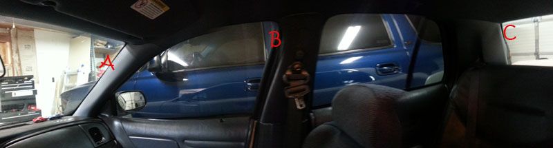

Ok i got your pictueres haha so here we go.
This is a panaorma of my passenger side showing the A, B and C pillars.
Next Picture is showing you the C pillar. The red arrow shows how to pop of this cover. You just light tug on the top and itll start popping out. It is pretty easy to pull off and may require the door seal to be pulled off some. Also the seat belt does not need to be removed. The blue arrow shows where the push pin use to be. I never got new ones yet because it really doesnt make the headliner sag. Both pins and both driver and pass cover may need to be removed.
Next few pictures show the passenger foot well. It shows where my scanners power cable is and where the grounding block is located. For this cover it can just be pulled toward the rear of car and will come off. It has to push pins that hold it in place. They should not break if you pull slow and steady. The green arrow also points to the grounding block.
This picture shows my power cable and how it is attached to the old spotlight HOT wire(Green and yellow wire).
The last few show my antenna and scanners location.
Black plug was old antenna spot on the roof. The plug is kinda hard to see in pic.

That should help in a way but i know a step by step guide on removing the headliner would help haha. Since the hole is so close to the passenger B pillar, im thinking you will need to remove the A-B-C pillars to get that side low enough to reach the hole. Then all you will need to do it run the wire behind B pillar cover then under your mat or carpet to the scanner.
