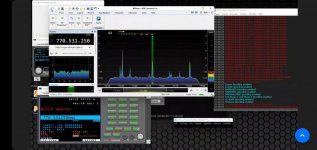

Something up with Lima? Waveform is visible on my SDR & seeing signal bars on my SDS100 but am no longer getting a data link. Ya'll playing games with me? :ROFLMAO:

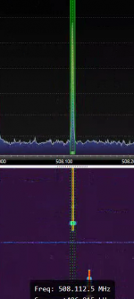

A handy tool for the toolshed...
Just click on the map for each time progression.

We also use this as its real time... it's VHF but UHF is not far behind when the band opens.
Thanks Steve! You can never have too many tools in the old toolshed...
