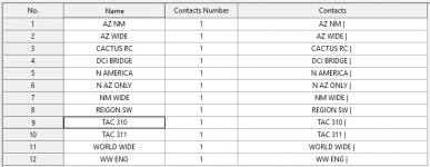

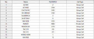

I bought a DM-32 and thought I had a dud radio as I would get audio on analog but not digital. I've tried programming this radio every which way for a local DMR MARC repeater. I have included some screenshots of my programming to see if anyone could help me or give me some input. I have 2 of these radios now to double check, and have had no progress. Any help would be greatly appreciated.

DMR repeaters generally enable a limited number of TG on TS at their discretion. My expectation is the repeater is listed on a local amateur radio club webpage with TG & TS support they support. Keying up on a TG not supposed or the wrong TS will seem like a dud radio. If the radio has promiscuous mode or Baofeng name for the function that allows decoding any TG on either TS turn it on. Radio should show TG number and TS when repeater is active. It will give you a good idea what is enabled and active.

Are you keying up the repeater when you attempt contact on WORLD WIDE talk group? The repeater will shut down this TG after 10 minutes if no local PTT's are seen. Are you close enough to the repeater to access it?
I apologize for the late reply. Yes I’m keying up and within range.
