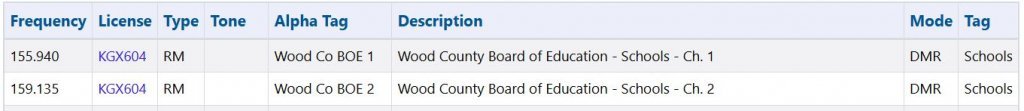

Hello. I have a quick question that I hope someone can help me with. Hopefully it's not too rookie of a question but I can't seem to figure it out. I have mostly Uniden scanners and have a 996P2 running in my downstairs office. However, upstairs I have a TRX-2 that I picked up. I have it setup and can hear everything the Uniden does except for DMR. It's not a huge deal but the only DMR system near me are our county school busses. I'd like to see if I could simply make it work so I could hear them since it is DMR and I could test that functionality on this radio. Is this setup correctly? Any help is greatly appreciated and I'm a newbie with Whistler radios and software. Thanks!!

Thanks. Gave that a shot but still nothing. The radio setup seems simple enough so I’m curious about the info in the database being accurate.

Try doing a search around the range of the frequency you want, maybe the database is wrong, maybe they went back to analog, maybe the time slot is wrong, any number of things could be happening but doing a search should let the TRX stop on it and give you the proper info.

Yes, pressing the WX button does play weather. On an interesting note, I messaged a lady local to me who advertises that she can program Whistler. Here is what she says. I don’t believe I’ve ever seen a Wood Co BOE talkgroup ever mentioned on SIRN.

They are indeed on SIRN now and not the VHF DMR system, and they are encrypted with ADP (RC4) encryption, and there is no listening to them. I have a batch of updates I need to submit for SIRN in Wood County. Just waiting to capture a few more talkgroups of interest before I do.

Interesting update, thanks! Not a huge loss and I’m really surprised they went this route. I was just curious if I could pickup a DMR system mostly and not too interested in their actual radio traffic. It’s surprising they’re encrypted when medical traffic between ambulances and hospitals are wide open. Also, isn’t encryption and the radios needed for that significantly more expensive?

I'm not 100% sure but I believe the bus garage may have gotten some "hand-me-down" radios from another agency. I have seen other agencies aliases show up for a while for their radios, and then after a while it gets updated to "WOOD BOE BUS XX"
As for the encryption, they are running ADP, which on most radios is software based, and not very secure, but enough to keep most listeners out. I am not 100% sure but I believe they are starting to use it for more than just busses. Also FERPA - basically education's version of HIPPA - is very strict on giving out student names over non secure means. This way if a bus needs to radio in about Johnny, they aren't in violation.
The EMS-Hospital communications HIPPA wise, do not have to be secured as long as no personally identifying information is transmitted. There are also exemptions to HIPPA for dispatch and emergency situations, but I have never heard names go across any of the Westcom talkgroups.
Pretty much all of the radios used on SIRN or any P25 trunked system are a little pricy. The ADP encryption upgrade is just a software purchase on top of the radio. Last I saw anywhere it was around $150/radio for the option. Though I have heard of Motorola giving it away depending on the purchase size. When you start getting into AES encryption it becomes MUCH pricier.
If you want a DMR system to monitor - Yellow Taxi is running DMR on 452.150 - CC1 TG1 SL2. They are a little weird how they do it. The dispatcher talks on talkgroup 1, but the radios in the cars do a private call to the dispatch radio. If you want to hear both sides, make sure you have a wildcard set on their system.
I think from a prior thread you said you were out towards Lubeck - I am in the same general area. If you are on a high enough hill or mobile up toward Vienna, mall security is using DMR, their info is in the database.
With some sleuthing, Kraton Polymers - the old Shell plant in Belpre - is running DMR, though there was talk of them encrypting when they rolled it out. Not sure if they ever did or not.
I was doing some searching last night and it appears that Lattamus communications have a system that isn't in the database in the area. One of the frequencies is around 452.7375 (or maybe 1375, it was a long day yesterday and I didn't commit it to memory) though DSD was only showing data, never saw any voice. Need to do some more searching and get it added to the database.
