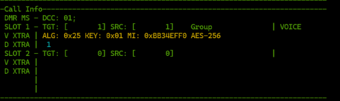

The DM-32 with an AES256 key does not use the same MI/IV like you stated as shown with DSD-FME. The MI changes constantly during a call.

Your test is not performed correctly, you need to display the PI HEADER.
There is only ONE Pi Header per transmission.
Use:
dsd-fme -Z 2>log.txt
and look for the PI header: PI H- in the log.txt file
What you show is the LFSR which is generated from the Pi Header.
Slot 1 DMR PI H- ALG ID: 0x24 KEY ID: 0x0A MI: 0x12345678

PI H- MI still looks randomized to me. Then subsequent PI C- MI are seemingly random after the first one.

View attachment 181471View attachment 181472
Ok, there is no backdoor with fixed PI Header in your DM32. Can you give the firmware number?
If other people are doing the same tests, we may be able to check if it's a backdoor, or if the firmware of all Chinese radios was produced by a single manufacturer and the same bug was copied everywhere.
Because someone posted in another topic that the Radtel RT-4D has the backdoor and I myself saw a fixed Pi Header in a DM32 model that I was shown.
Can you do some more tests because visually the PI Header doesn't really look random.
Have the Chinese introduced another backdoor that is less visible than fixed MI?
In both of your tests I see identical parts:
70E55B70 70x55x70
5AF70AF5 5AFxxAF5
Could you do a dozen tests to see if these identical parts are repeated?
The Pi Header should be completely random and not have these kinds of identical parts.

My DM-32 is on firmware version DM32.01.02.046. Attached is log.txt from DSD-FME of 12 calls, PI.txt is the output from grep of "PI" , It looks like only the first PI C- part contains the PI H- MI and all subsequent ones are different for the rest of the call. I did this with an RTLSDR, with no antenna to prevent overloading.
This is the same case with a DM-32 on firmware version DM32.01.01.040 (stock firmware).

Your DM32 has no backdoor problems, the MI are very different, random and are 32 bits long.
