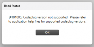

I picked up a used XPR6550.
I am running the latest CPS2.0 (ver. 2.155.258.0)
When I attempt to read the codeplug I get the following error:
"[#101005] Codeplug version not supported. Please refer to application help files for supported codeplug versions."
The firmware version in the radio is R01.06.00
I downloaded the latest firmware package: MOTOTRBO_R011217_130203_PortableNA.exe
When I attempt to install the package (run as administrator) I get the following error:
"MOTOTRBO CPS must be installed before installing this package"
I am receiving the same error on both a Windows 11 desktop and a Windows 10 Laptop.
Any help would be greatly appreciated.
