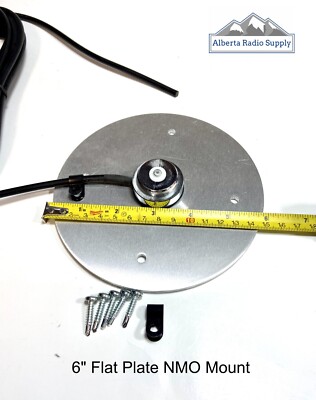

Why not disguise an antenna as a vent pipe on the roof of the mobile home? Use a mag mount or random piect of thick sheet metal with NMO mount then stick a piece of grey PVC pipe over it. You only need about 6" of pipe to hide a UHF 1/4 wave whip or a little over a foot for a 1/2 wave or 5/8 wave. Here is an idea for a surface mount NMO that you could add some PVC pipe to. Stick a used Laird B4303 on that and you should be in business.

Since that roof is (probably) aluminum, you'll need some sort ferrous metal on the underside of the roof to hold it on. One brand of CB mag mount comes with a large washer for that purpose.
If the roof isn't some sort of metal, you can still use a mag mount, but you'll have to make a small ground plane for it with aluminum tape or such. Hide the antenna in PVC like @prcguy mentioned, camouflage the co-ax, and no one will ever notice. That will be your most cost-effective stealth antenna with usable performance.
