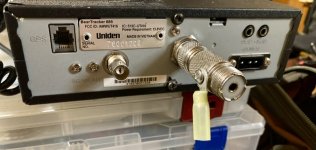

On a CB/Scanner hybrid radio I experimented using a WORKMANN Lightning Arrestor to ground the coax shield to cut noise.
Am using it again on present mobile with a feedpoint choke at antenna.
With the U885 you can see I had a little too much time on my hands that afternoon. I’m not recommending for or against this approach; YMMV.
These adapters are cheap. Price & quality. Tap it into place then screw threads. Don’t pull it on with threads. Tap tap, (turns). Again.
