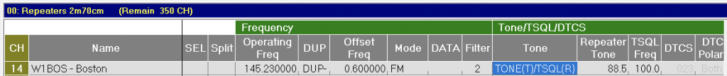

This is the first repeater I have come across that has offset Tone-In and Tone-Out values. Assuming Tx code is 88.5 PL and Rx code is 100.0 PL:
The terms in the ICOM manual are a little confusing to me. This is what I programmed in. Was curious if I have this entered correctly per the ICOM Programming Software manual (see below - I am going by the bottom line):

The proof of the pudding is in the tasting, but yes that looks correct.

At least some Icoms will allow "tone translation." My 2730A allows it just as the set for this 705 is displayed.
If you use "Tone" that only works when transmitting. If you use TSQL you can set a different receive tone as above. You can also set the TSQL to the same value if the repeater transmits tone as we as receiving it.

I have not encountered any of my radios not allowing different PL and or DCS tones for TX or RX. Others have told me it will not work. I then take their handheld and it works when I hand it back. In particular a friends repeater that uses PL on output and DCS for input. Even for different PL on TX and RX.
Perhaps that fixed PL for TX/RX was on older radios.
