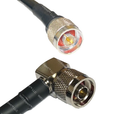

I have purchased Times Microwave coax from wifi_expert on eBay. They will make custom cables
Here is an example
