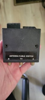

A passive splitter attenuates 4dB so check if that are aceptable. A suitable switch for transmit are linked below and also get pigtails or adapters. If you try and get F connectors at each device, using adapters, you can use cheap ready made coax lengths with F connectors.
/Ubbe
Looks to be for tv, buy would this work? I thought this type of connection were only for a/v..
Ubbe
Sep 8, 2006
11,071
4,751
Stockholm, Sweden
It's not made for transmit, the switches are probably too weak for it.
You absolutely need a switch that grounds the connection to a scanner to protect it from damage when you transmit with high signal levels.
/Ubbe
