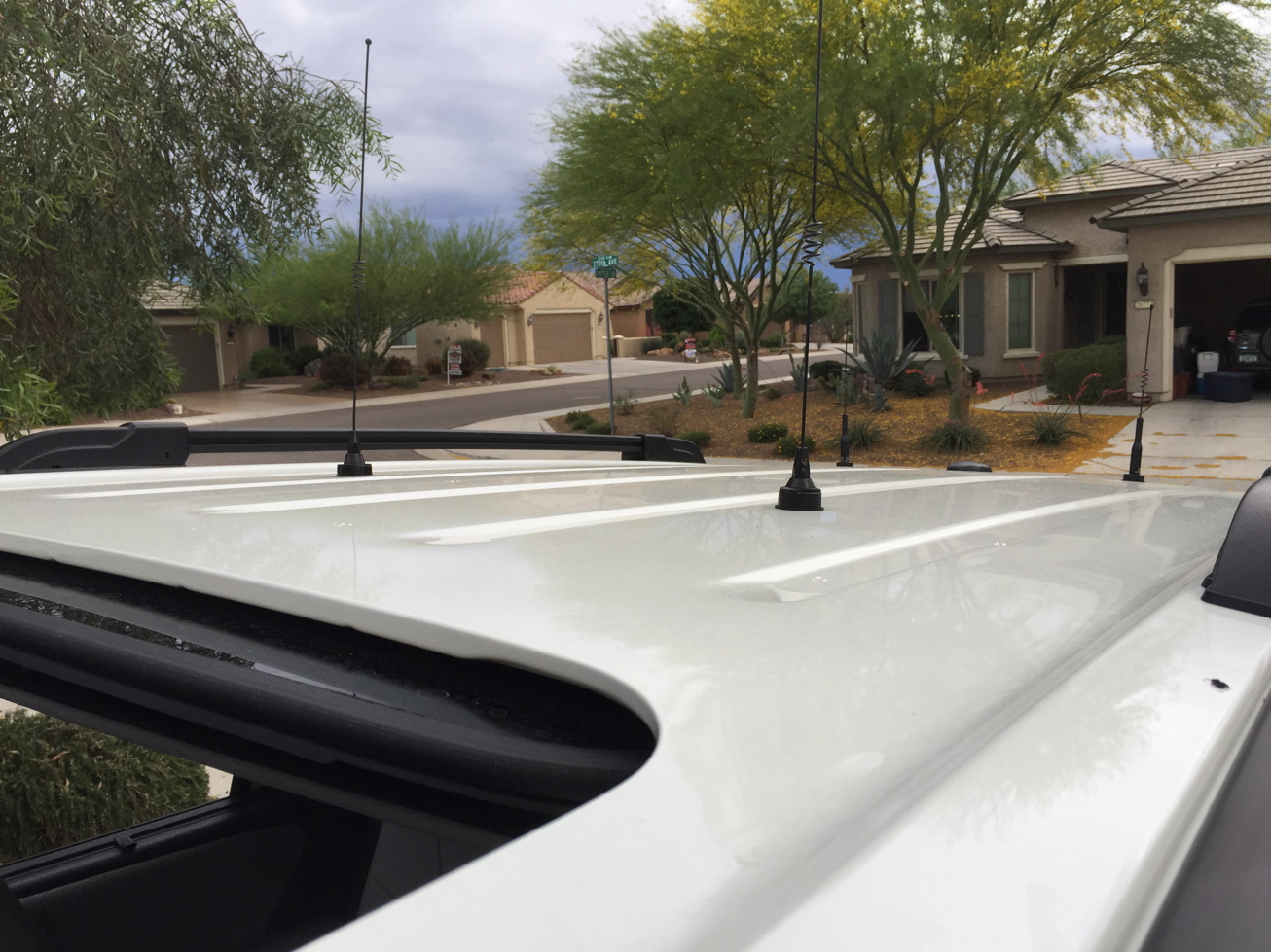

Below are the antennas. They are pretty straightforward NMO mounts with Comet and Larson dual band antennas. These work well for the scanners too. 1 is reserved for the IC-7000, 2 are connected to the scanners and one to the 638.

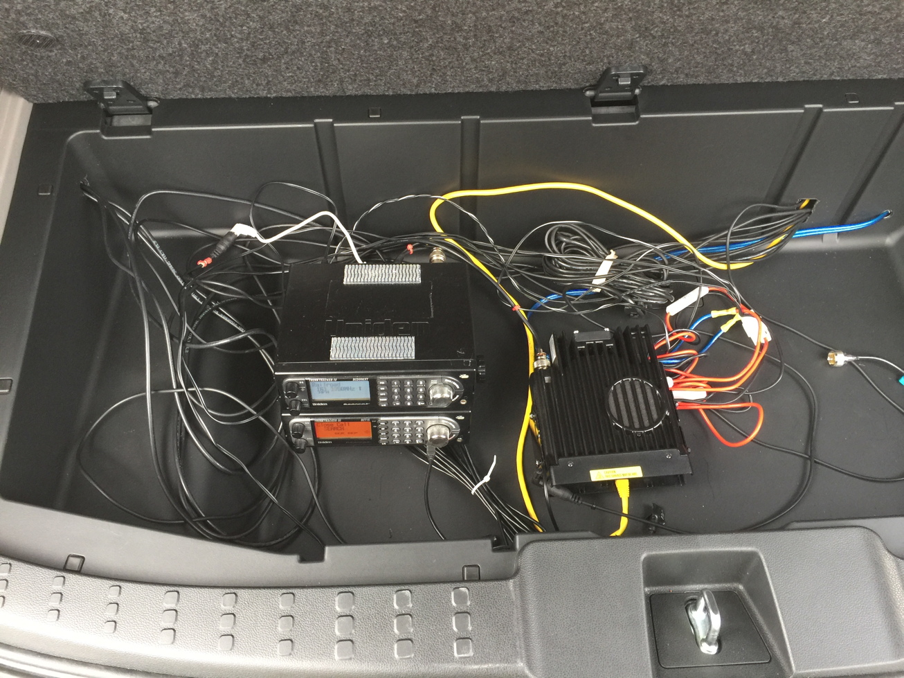

The radios themselves are located in the covered cargo area at the rear of the truck:
You can see the spare antenna cable for the IC-7000 and the space it will go in once I get the antenna figured out. The remote head cable is already in place.

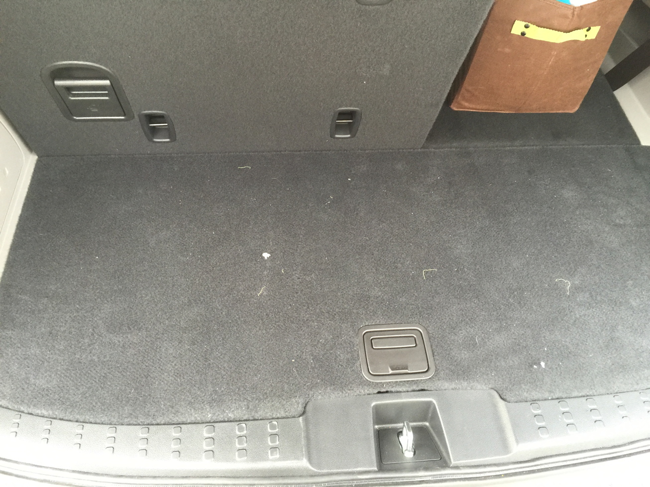

When you close the cargo cover the radios are out of sight:
