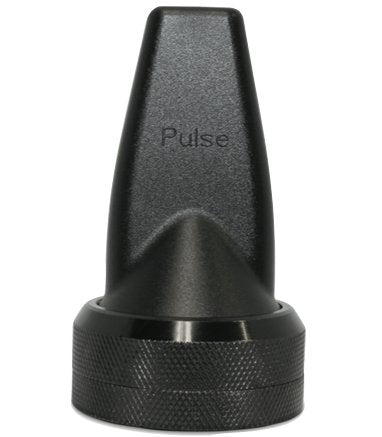

Ooooo I did not know that. Ty for the recommendations!
I also saw this
NMO5E2400
