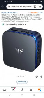

I can recommend the mini PC in the attached image for updating your Alinco DJX-100.It doesn't break the bank and I got mine for less than £130 UK price.
