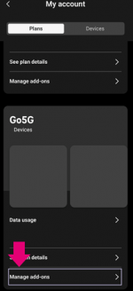

T-Mobile SMS/MMS issues:
Anderson, Lylah <@t-mobile.com> wrote:
The fix for these end-users would be 1. Call into CARE and request enterprise messaging added to the line or 2. For self-service option the user can go to the T-Life application , login to their T-Mobile account, go to manage tab at the bottom right, select see plans (top right), scroll down to phone plan and select manage add-ons, scroll down to line level services and select enterprise messaging ($0.00 cost). See images below:
