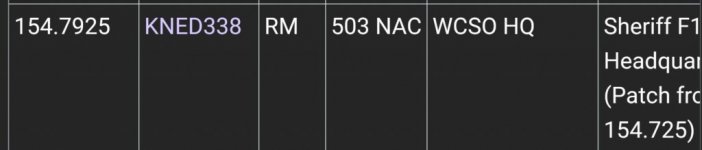

I think I may have found it. It is a p25 conventional frequency that is a patch of F1 dispatch of Warren County Sheriff's Department.
I hope the original poster returns to confirm this.
