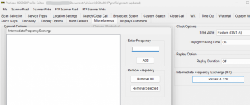

No, you don't. Read my post above this. Go into Sentinel, edit Profile, go to Misc tab, edit IFX table, upload, done.
Came to say the same. I've never used the method Trentbob mentioned and did not know it existed :) Always did it in the profile.

So after a long, arduous debug session, I finally discovered that this one trunk control channel "requires" IFX to work with my SDS200 scanner
Do you have a FM broadcast or TV tower close to you. You may be having image or intermod problems. I assume you tried all of the filters.
