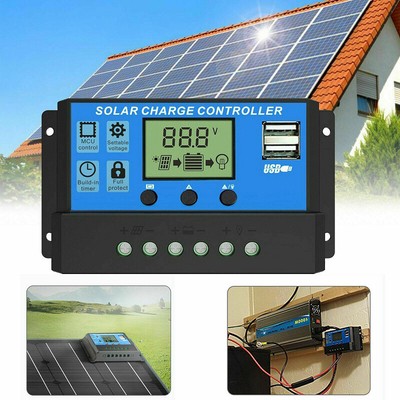

I have a couple of these solar chargers and they have been working great for the last year and are really inexpensive. They have programmable parameters and will handle up to 60A, although mine have only seen about 30A and they will shut down if the battery gets too low. Not bad for $23 including shipping.

I am NOT looking for a charger. I am looking for a device that will switch to the battery when the main power goes down and when the power comes back it will switch back to the power supply leaving the charger to recharge the battery. Even though the technology is interesting i am not interested in a solar solution right now. Maybe what i'm looking for does not exist.
Look at the photos. Your charger would input on the "solar" input. Battery goes to battery, and radio load would go to the "lights" out. That's about as close as you will get to an out of the box option.
You could build your own with two relays. One SPST normally open (off) and one SPST normally closed (on). Normally closed would go on the battery positive lead. Normally closed would go on your radio power supply positive lead. Daisy chain the power supply positive through the inputs of both relays, ground back to the power supply. When the power supply is on/powered, the battery is disconnected, and when that PS "fails" it disconnects the power supply power and allows the battery to flip on.
