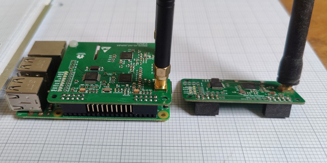

Do they have USB on the MMDVM hats? Single and dual MMDVM examples (none of the ones I have feature a USB plug), dual plugged into the expansion pins of a Pi3b as an example of how I'd expect yours to look.
