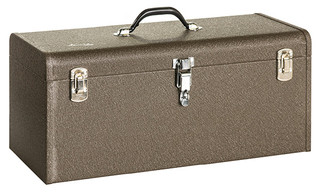

My dedicated electrical toolbox is a steel KENNEDY KIT I gave my father just about fifty years ago. He had his brothers’ K-K SoCal Douglas Aircraft plant toolbox used before being called up by the Navy in ‘43. It was his fly fishing box after his brother never returned from the Pacific.
Being from Colorado and getting up into mountains to fish on weekends brought back the same trips with his brother and others who were gone.
And a couple of months later I backed over the removable tool carrier with a 5,300-lb Chrysler T&C.
That handle still deformed.
I have the other box as well.
(Not exact, but close):
Character, right?
That tool carrier has made a whole lot of round-trips from the tailgate on radio installs.
Character, right?

What a coinkidink. This was my radio/car stereo installer toolbox from around 1976 through 1981. We had no inside installer bay and this went through many snowstorms and blizzards outdoors while I was upside down under dashes with car doors open and the cars filling with snow.
Guess we could market a special edition RR Radio Installer Box with letters of endorsement.
A K24B runs a bit higher price than in the 1970s.
