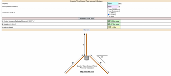

Length would be about 11.7' according to the google. My deck might be just long enough, or might be able to do that or as a V?
Are we taking about the quarter wave or the dipole?
A quarter wave ground plane antenna is going to be a bit under 6 feet at 40MHz. A dipole will be around the 11.7 feet total length for 40MHz.
The dipole can be run as a V, but it's going to work better as a vertical as most of what you probably want to listen to will be vertically polarized.

I used it as an example, since you had mentioned wanting to operate on 6 meters after getting your license. You can use that calculator for any frequency - try plugging in 40 MHz, which would put you in the middle of the 30 - 50 MHz range.
