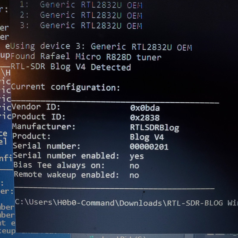

Did you rename the blogv4 at some point?
If you download this
rtl-sdr-64bit-20250126.zip
(With only the blogv4 plugged in)
Extract it, open the folder, type cmd in the file explorer address area, press enter, in the cmd window type
rtl_eeprom
What's the output?
rtl_eeprom
What's the output?
I did rename it bc I was getting confused on which one was which on my hub.

You can change the Friendly Name - that should not cause problems. Something like this procedure:
yeah changing the product back kept the friendly name in device manager.
