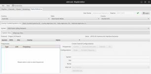

For the life of me I cant work out how to get RR to setup P25 PII systems on SDRTrunk for Linux. it looks like theres a part missing from the RR section after ive logged in. Ive taken a screenshot of where im at. I have had SDR Trunk setup on linux mint before but now im running abutu
Any advice would be appreciated
Cheers

What version are you using? I am on 0.6.1 Windows. It initially took some time to populate, but its listing the sites.

The Playlist Editor always seems very sluggish when enumerating large systems. On weak platforms (Raspberry PIs for example) I have always had a tough time importing large systems. It takes forever for the information to show up, and then takes forever to select the large number of groups. Oftentimes I'd just have to walk away. On a decent machine with CPU resources to spare and enough memory dedicated to SDRTrunk's Java, I really don't have that problem (although I can still notice that I'm trying to pull in a large system).
Assuming you have CPU resources and RAM, if you know how to increase memory for Java in SDRTrunk that might help. I can't guarantee it though.

Make your playlist editor window larger so that you can see the parts you're missing.
