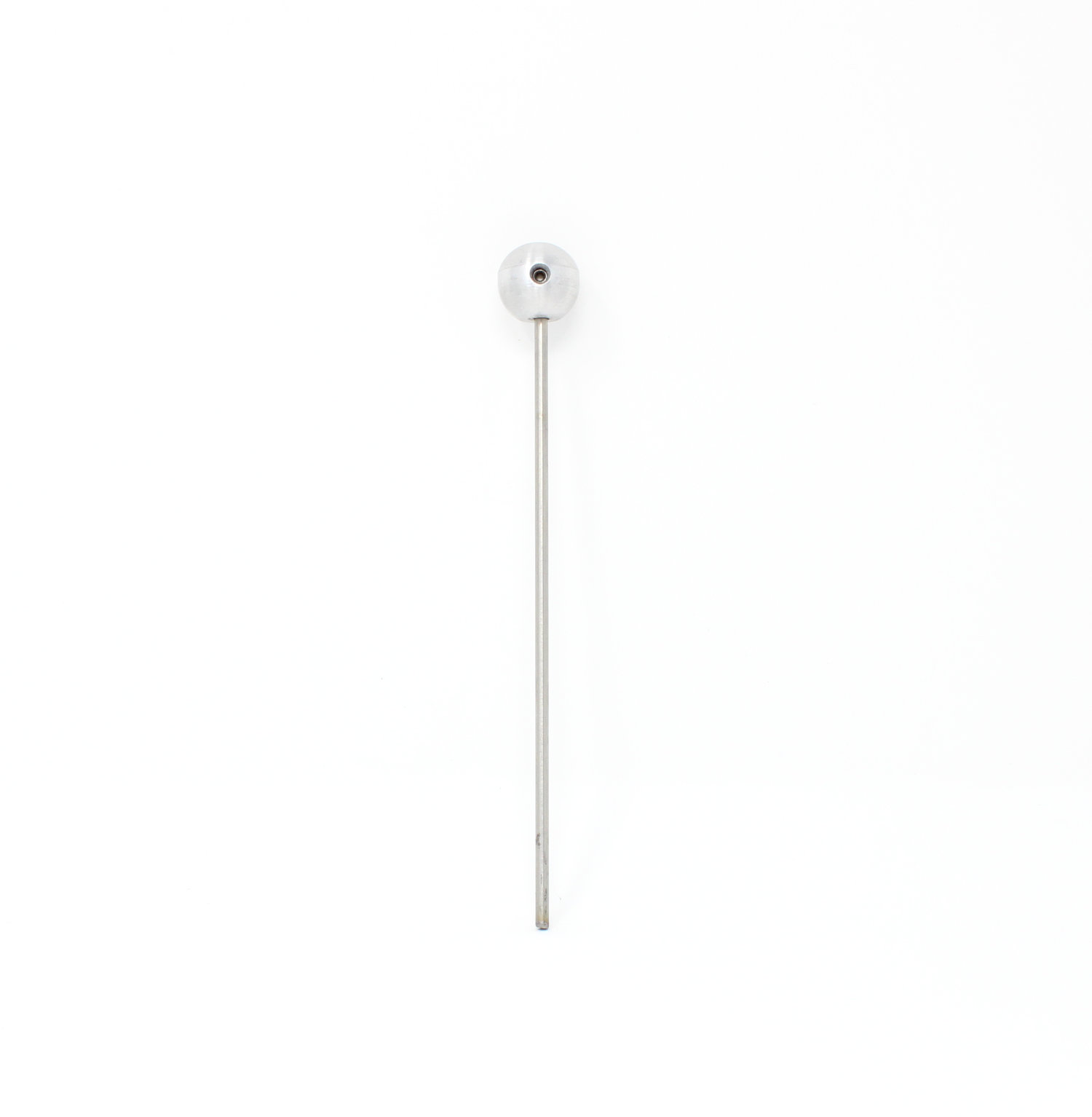

Have seen this question come up about rust. The SKIP SHOOTER antenna uses a common nail as the length-adjusting tip (held by an Allen screw). Yes, it will rust.
I’ve used a Dremel to polish the nail to a fair shine and used FLITZ to finish. This seems to work well for a period. The Dremel can also get inside the antenna a little ways (to screw head hole).
I’d imagine it’d be better to use a “nail” of a material which won’t rust easily (stainless, etc) as a substitute from new. I’ve seen the comment that the originals used a piece of solid brass rod.
The worst of my 4-5 pairs of SS antennas I hadn’t prepped (as above) had the nail stuck so tight that two pair of Vise-Grips couldn’t get it out (great care gripping shaft at base) so I resorted to the best rust penetrant:
50/50 Synthetic ATF & Acetone
PB Blaster, etc, is not at this level.
KROIL, Mouse Milk would be close.
A few drops around shaft and into Allen screw hole, then stand it in a corner.
The nail will come out the next morning. @CDX951, if it won’t, try again.
