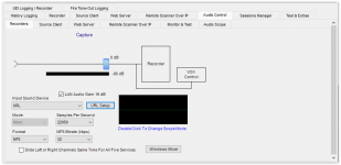

Work on the audio problem first. Do you have audio on the server side? Go to the Audio Control tab then select the sub-tab. See if the audio meter is moving. If not then click the URL Setup button and see if the audio bytes are incrementing.

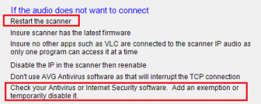

I have looked on each sub-tab recorders to Audio Scope see if any movement. Just a flat line.

I went to the Mcafee and firewall and added to the mcafee and firewall click to allow. I see the audio bar movement and I click the loop and hear aduio.
