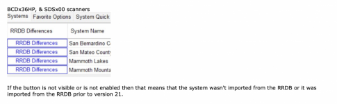

Well I just realized I was using version 17 of the Manual :rolleyes:
It shows 1751482846760.png but it does not show enough of the screen so I can see where to find this......IT CAN'T BE THIS HARD

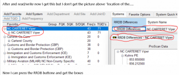

After and read/write now I get this but I don't get the picture above "location of the......
Now I can press the RRDB buttone and get the boxes

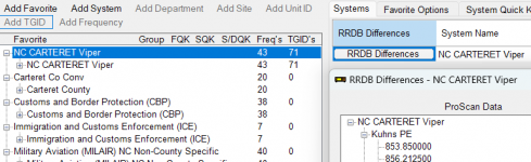

Just an update.....got on RR today and check and the RRDB Differences button is there and still works w/o are read/write.....
I was using 23.5 so I don't know why I had this issue but it does appear that IF not there, try a Read/Write......
