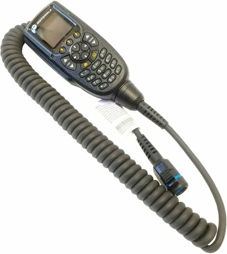

And while I'm here is a HHCH available for this radio?

The XTL radios are not FPP. Sorry. A HHCH is available, but they’re more expensive than the radio. You may find them for less, but not much. And while some radios are programmable from a keypad, you still need CPS, & a cable to program many settings like menus, zones, button functions, etc.
