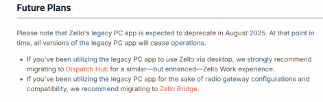

Effective 25 June 2025 Zello is deprecating older Zello app versions:
  • Android app versions older than 6.0.2 (Note: newer versions no longer support Android OS versions earlier than 7)
  • iOS app versions older than 6.1 (Note: newer versions no longer support iOS versions earlier than 14)
  • Legacy PC app – all versions
These changes apply only to the free version, ZelloWork is not affected.
See here for more info and a workaround to keep older versions working: https://support.zello.com/hc/en-us/articles/36830119152397-2025-Service-Changes

Turns out the current desktop version is only for ZelloWork users. After August 2025 free users will only have Android/iOS.
EDIT: Zello Bridge does work with the free version, but requires a token. I know nothing more than that. Trying to migrate from legacy to bridge is a PITA!

I spent a little time looking over the New “Zello Work” dispatch hub replacement for the PC app that we have all enjoyed for so many years and I don’t think they are referring to the free version PC app I think they are referring to the “Work “ app.. Nothing lines up and there is no import export file directory listed for the free version app. So right now it’s days are numbered.. But we all knew that it was coming because software doesn’t stay free forever these days ..So far Linux os is still! I have one feed here in SC that I have a few listeners But there are some Major Public safety agencies that maintain there whole infrastructure on Zello . Such a shame but hopefully myself or maybe someone else will come up with a good alternative, Bye Zello:(
