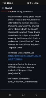

HDSDR (a Windows SDR software) is unable to find my HackRF, even though the official HackRF Tools software can find it. And yes I do have the correct ExtIO DLL file for using the HackRF with HDSDR. It immediately shows the error message "No HackRF devices found" when I select the ExtIO DLL for the HackRF. I've attached a copy of the error message box here.
Can someone here tell me what's wrong? Does HDSDR depend on a different driver being installed for the HackRF than HackRF Tools use? I know that when I first plugged in my HackRF and set it up I used the Zadig driver installer to install the WinUSB driver for the HackRF, and this worked for HackRF tools, and I THOUGHT I remember it also working for HDSDR. I haven't used my HackRF in a while, and just decided to use it again today, but now it isn't working with HDSDR. So I don't know what's wrong. Can someone here maybe explain how to fix this error?

That was the first thing I did, I made sure that the WinUSB driver was installed for the HackRF by using Zadig. The last version of the ExtIO DLL was from 2015. Maybe it's outdated, and no longer compatible with a HackRF running the latest firmware? I think I updated the firmware like just a year or 2 ago which is much more recent than the last release date of the ExtIO DLL.

However what I did eventually find is that if I moved it to a different USB port, it then worked with HDSDR, and is still working with the official software. It seems that the way the ExtIO DLL works, is it expects the HackRF to be plugged into a specific USB port and uses very low level commands to access that specific USB port (maybe the one internally designated as USB port number 0 or 1, depending on which number is normally used to designate the first USB port in a computer).
