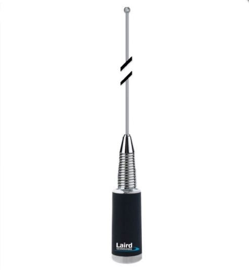

I don't believe the lies of many companies... but this sounds so dog gone good.........the ad say's
This antenna works like a 102 inch whip antenna but is ONLY 53 INCHES LONG
should I believe it????
Nope, it’s a flat out lie. But for a base loaded NMO antenna it is very good.
Yeah, the appeal of a low key appearance weighs heavily in favor of base load NMO.
This 6’ 8” is a page from the same book, but it’s not the same chapter in regards to appearance.
On a current 4WD pickup, though, this is past head height for most folks. Only the whip would be noticeable.
(SIRIO 5000 Performer on a Breedlove Mount. Several models & configurations).
I looked for the Antenex/Laird CW27 with 67" whip.... no dice anyplace.... I like the idea slowmover said about cutting down a 64" whip to allow me to get a taller antenna if I can get it to cut right

Nothing will compare to the 108" whip, but I used the Larsen NMO 27 on my pick up truck for years and it was actually a damned good antenna. If I still ran a CB that's what I'd have on my Subi. But, at least here in SoCal the CB band has devovled to nothing but racist, homophobic rants and Spanish speakers running 1000 watts. So I'm done with it. Maybe if I lived in some place more rural I'd give it a go again.
The hood mount should work pretty good for you. Just make sure to crank down on those allen bolts to get through the paint and make a good connection to the underside of the hood. I'm curious, do you have much CB activity around you?
Mmckenna and a few guys I value their opinion, really love those larsen antennas.... I'm going to try a K-40 trunk lip mount on my friends jeep on the hood it's 57 inches tall but that whip is THICK... I'm thinking I'd like to find a more flimsy whip but I have a K-40 he can have so that's the cheapest and easiest way out.... if the K-40 works I'm done.... if not I'll try a Larsen NMO antenna and probably that one that say's it's as good as a 108 whip ( I know what a joke...but until I try it I won't knock it)

I loved my NMO-27 and used it for decades (I think I bought it almost 30 years ago). It's still up in the garage rafters, just in case I ever decide to try again.
Actually, few have tried buying the Larsen NMO-30 coil on it's own and a separate 64" Larsen whip. That is said to give a bit better performance than the NMO-27. Only drawback is that you have to spend some time with the tuning as the cut charts for the NMO-30 coil don't cover down to 27MHz. The Larsen whips are pretty thin and really flexible. Would be a good way to go on top of a pickup.
