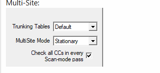

I cannot find this "multi-site table you posted.

Click on the down arrow next to stationary and you should see a list for multi-site as a choice.
That's on the TSYS Objects tab.
On your original file, you had it set as "Roam".
Set as "Roam", the scanner would look, and only use the control channel frequency with the best signal. Since the frequencies for several sites are loaded, you'd only hear traffic for that one site. For example, if it grabbed & used the control channel for the New Braunfels site, all you'd likely get would be NB talkgroups. You'd miss transmissions of other city or county users that were on one of the other sites, not the one assigned for New Braunfels.
I set the MultiSite mode to Stationary, and checked the box to check all the Control Channels loaded each time the system was scanned. If it was set as Stationary, but the box was not checked, it would check the control channel for the first set of site frequencies on the first pass through the system.
On the next pass, it would look for the (different) control channel of the second site.
On the third pass, it would look at frequencies for the third site.
Once it had checked all control channels found, it would go back and start the cycle again, checking for the first site once more. That pattern repeats itself, cycling through the sets of control channels, one at a time. By checking the box, you're telling the scanner to use any sites control channel traffic each time the system comes up in the scan rotation.

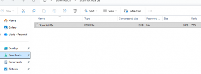

this is what i get when i find the file.
when i select the zipped file a text file appears
the unzipped file looks like this. once i am in win500 i cannot find the file from import. i know where it is but win500 is not seeing it.
okay i fixed that bit
That view looks like it's still looking at the compressed file (that's the one highlighted in your post; out to the side it says "zipped".
Use the second link I posted. That file is not zipped, and once saved to your PC, you should be able to import it into Win500.
(To reduce 'confusion',delete the file that is zipped.)
