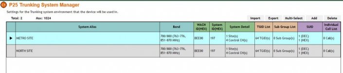

double click on a knob position to open it...You see it is MONITOR that means it only scans the TGs you selected. Currently voice storage is turned off, if you want to record all call it can be changed.
Go to close to the bottom and you'll see the TGs on the left, add or delete what you need for each zone.

OK so I just need to add the TG's for each site. What about that knob position 6 RISCON ALL? What do I do with that cause I already have the 5 separate sites? Is this knob position 6 just a pool of all the other sites?

Yes 6 is everything with a wildcard (called Group 1 because I forgot to change name to wildcard before I sent it) to catch all comms, but they will only be displayed by TG number, not name. If you want to delete it right click on the box and select DELETE.

OK I will probably delete cause I dont really need it....what about the control channel and voice channel freqs? Are they still needed?

Everything is programmed for those, deleting a knob position does not delete systems imported, it only delete the knob slot.

One thing I forgot to ask is I put all of my talk groups on all 5 sites in the priority talk group list section. Does that matter as far as scanning? Should I have put them in the non-priority?

Putting them in priority means voice monitoring stops while they jump to the priority. It is recommended that Priority be used (if you must) on only one or two important TGs. Otherwise, the voice traffic will continually be interrupted and you may miss something important. I do not have any TGs on priority.

Ok I am waiting for radio to arrive this afternoon. I will go back and put all talkgroups in priority into the non priority space. I don't need a priority channel. When I get radio and charge it up, should I READ FROM RADIO first thing? I am hoping mh radio model is the same one I used to create the codeplug!

You do not need to read from radio, but it is a good idea, that will add another profile and give you the original info from the pager. Then you can program the pager using the profile we created, just make sure the model is correct, if not convert it in the PPS.
IMPORTANT: Export profiles and save them as backups, always keep the original and at least one backup before you make changes to the PPS.
