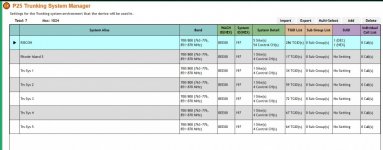

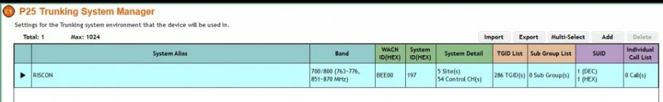

Here is what I have in C1......its the WRONG data...this is an old one I did earlier that has ALL 5 RISCON sites.....I cant delete it and I dont know where to go from here.
I didn't ask you to delete it, we want it there, now look at post 85 and do what I told you starting at the single sites by the red line, one at a time. Bob DO NOT worry about anything else, we need to take this one step at a time.

ok imported to public resources......
16,755
25,209
YES this is what I have

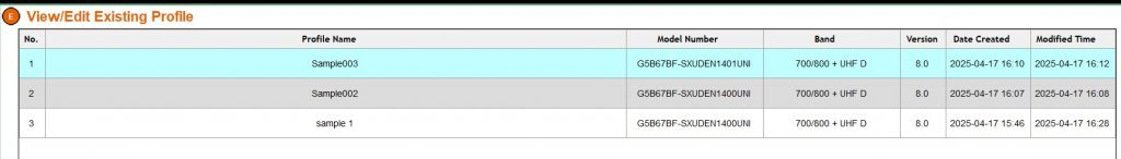

Okay this will work, but it is easier if you had imported all the talk groups rather than trying to add one later. but okay. Now go to tab E and you should see one profile in there, let me see what you have.
16,755
25,209
Then highlight Profile 3 and click edit at the bottom once the new screen opens take a screen shot
