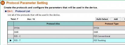

After you go to Tab E4 and add your protocols, I suggest you add all available protocols, by clicking add and clicking on the name. You DO NOT need to change anything below the list, just add the protocols and rename them to match protocol type.

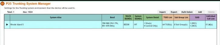

OK I imported the file you sent....heres what it looks like in the E2 P25 trunking system setting.
