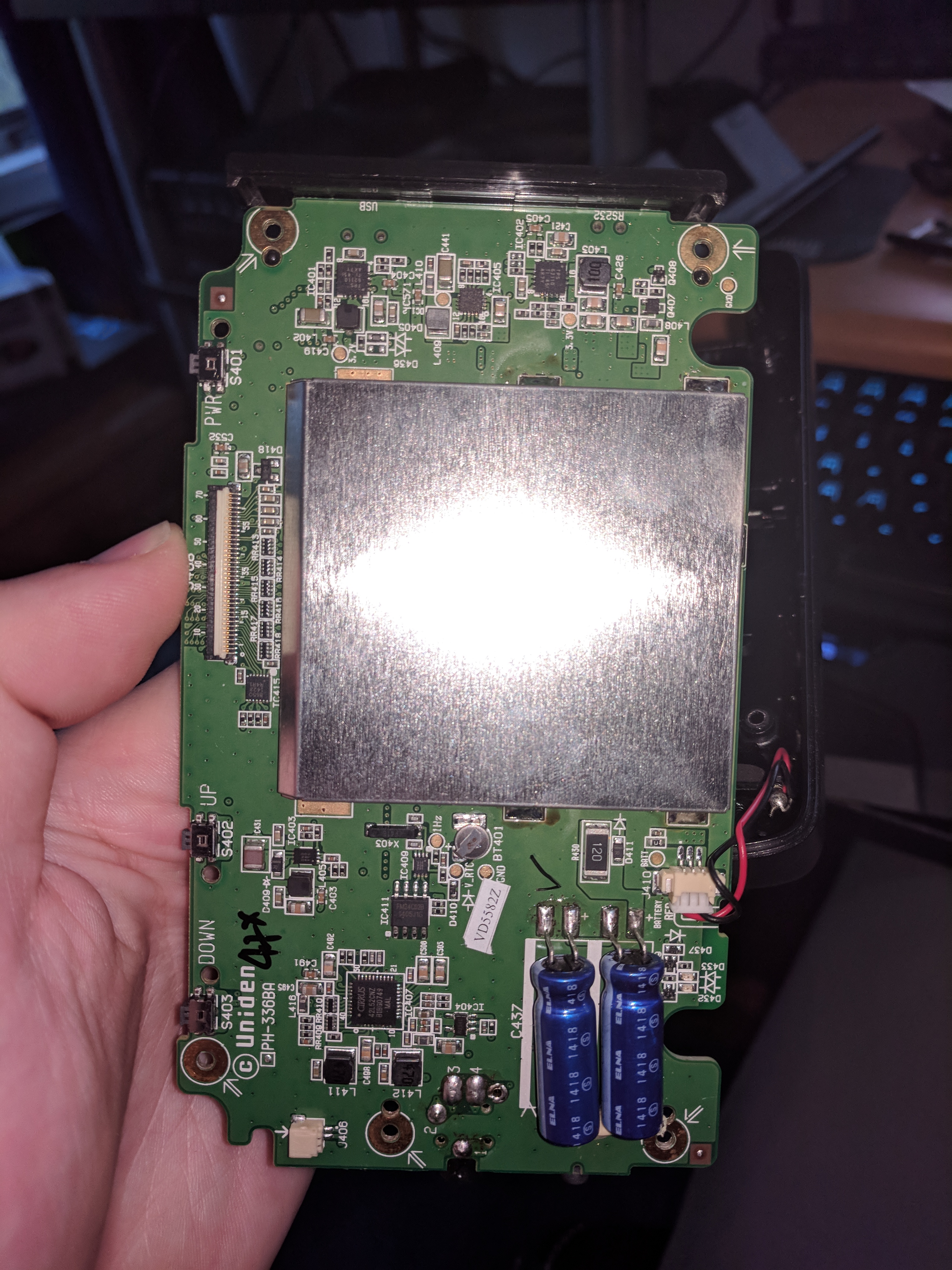

I took photos of said battery. It's next to the main shield, labeled BT401 on the PCB.
https://www.warpfactor10.com/downloads/IMG_20180508_190356.jpg
https://www.warpfactor10.com/downloads/IMG_20180508_190516.jpg

I cannot locate it at the moment, but somewhere else, I think I saw a post that indicated the HP series RTC battery was a coin type, under the display. If so, that might be user replaceable, at least for someone reasonably handy, though maybe not for the faint of heart.
From the HP-1..... almost the same position as in the HP-2 photo linked above
BT401 - front side of main board - between the blue caps and the RF shielding:
https://www.flickr.com/photos/25878703@N08/6905367921/in/album-72157629391302049/
Yes, if you have reasonably good soldering skills, and are able to find the correct replacement part.

Battery part number?
Anyone know the part number for that button battery? Is that just a little solder dab on the top to hold it in place, or does my soldering iron actually gave to flow solder to the actual pcb board? I'm comfortable tacking the top of the button battery, but might spend the $ with uniden if any board level soldering is needed.

So I have an HomePatrol 2 that I use exclusively in my truck, and it's a few years old. It started the clock issue recently. I opened it up and removed the tiny battery. It measured 1.2v on my meter. I replaced it with the ML-621S/ZTN battery that was recommended in another thread (available through Digikey).
Because this battery is physically bigger, I decided that rather than try to get it back into the same spot with the metal tab, I would just solder a wire to the - side and one to the + side of the battery, and then solder these wires to the pads where the battery would ordinarily mount. This also allows me to move the battery around so that it fits under the metal shield that screws on top of the board.
I'm going to run the scanner on a AC adapter for a few hours, and then measure the voltage of the new battery before I can claim success (this tiny battery is rechargeable so the scanner should be charging it).

So, an update on my repair. I was unsuccessful in trying to get a ML-621S/ZTN battery in place of the factory battery. I believe that due to the extremely small size of the battery, applying heat to solder it in ruins the cell (or I'm just not that great at soldering). I tried two different ML-621S/ZTN batteries and after soldering them in, and running the radio for a few hours, they only measured 1.2v or so. They should be about 3v.
Therefore I took an extreme hack approach that is ugly, but works great. I ordered an Adafruit CR2032 breakout board (about $2 bucks on eBay) and an LIR2032 rechargeable cell (same size as a CR2032, but rechargeable). The battery was also about $2 on eBay.
I slightly enlarged one of the speaker holes with a drill bit, and wired the breakout board directly to the solder pads where the factory battery would be soldered in. Then I used some rubber cement to glue the breakout board to the front of the radio. See the attached picture. Yes, it looks ghetto or techno-steampunk, depending on your perspective. But it works GREAT. And next time the battery dies in a few more years, I can just replace it in 10 seconds without opening the radio. Also note that in this position, it does not actually block the speaker, even though it covers holes. The speaker is pretty small and is actually only in the upper left hand quadrant of scanner as you look at it.
After you attach the breakout board and solder it in, and power the scanner on, you can use a voltage meter to check the + and - side of the breakout board. It should measure about 3.2 volts without a battery inserted. Upon inserting a battery (which came pretty much fully charged) I was able to power on/off the scanner endlessly without being annoyed with reprogramming the clock (of course after programming the clock once).
Ugly but it works and its a heck of a lot cheaper than sending it to Uniden or buying a new scanner and it facilitates quick and easy battery replacements in the future. Note also that you could mount the battery breakout board on the back of the scanner so you don't see it, but in my application it would interfere with my mobile mount setup.
