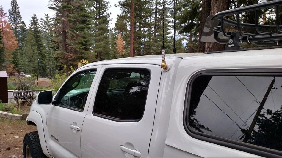

No worries with the headliner; Hole is going in the topper.
Company owns the truck, still can't drill there. But we split the cost of the topper. Ergo it's half mine.
Still a permission verses forgiveness equation if something happens, but more to my favor than a hole in the truck.
Cab and topper nearly equal length. Front of topper is nearly truck center and slightly higher (couple inches) than cab. Assuming proper bonding should be best location.

If I'm going to get the most out of that "Goofy Antenna" she's going on a puck.
Topper has serious reinforcement up top. 300# rolling payload and 700# static. So no worries with wind loading.
Has to come off when I hit the woods though, and still weighing options to protect the bare mount.
Topper has preinstalled rails for crossbars. Also still considering some sort of shark fin fore and aft to act as a deflector.
I plan to complete both installs and use a Coax Switch like this so I'm not jacking with coax too.
Just one QD off, one QD on, and the flip of a switch.
Flexibility for best performance in given condition.

**Giggles in HF**
"Moron probably screws wearing Micky Mouse ears"
P.s. This was just for kicks and they're already off... No need to throw shade...
If you have the toys you might as well play, and the cophase harness made for cheap fun.
Total height was 12' 5" but there's only 4' between them so no benefit.
Did manage to get SWR to 1.8. Probably could do better, but ran out of tuning nail.
For anyone else playing with SkipShooters a galvanized spiral decking nail fits beautifully and they come in longer lengths

Very nice that TTL Clearance at 12’-5”. That’s just below my “in-town” 7’ antenna at 13’ which I consider easy-to-live-with (I don’t do drive-thru as it wastes diesel + increases engine wear, and I don’t live where parking garages clearance is needed).
