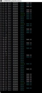

Interesting that the log still won't open and says Device 0 even though I have changed it to1, 2 and 3. I did go ahead and open the program and it is running. I'm hearing an occasional blip of audio come thru although not enough to understand. I do have TeamViewer still on my desktop.
Not sure why the log wouldn't open with that bat file, unless you accidentally removed the line in it to open it.
If you want me to remote in, I may be able to get on later this evening, not entirely sure. If not, perhaps Monday or Tuesday, will be busy on and off and not always able to sit down and work on it.

We can remote. I don't have a problem with it. The signal strength on SDRPlus was good. The "in level" goes up as high as 37% but it fluctuates up and down. am hearing audio but just blips here and there. can't make it out but can tell it's voice. occasionally flashes from green to white.
I guess I'll have to setup teamviewer when the time comes. The shortcut is no longer working. always something but can be done I'm sure.
Okay, so here is what I've found out today. Due to the way squelch is handled by DSD-FME internally with the RTL dongle, any squelched audio input from it will effectively stop the entire process of DSD-FME until signal is regained. That means, that in a trunking NXDN session, it just stops after its first tuning assignment, if it can tune at all. So, for the time being, becuase trying to fix this particular piece of code for the internal RTL support is not a simple task, NXDN trunking will not work properly with the RTL dongle input since if we turn squelch off, it will constantly gain tons of false syncs and not tune properly, but if we enable squelch, all processing halts and it stops tuning.
NXDN48/96 trunking is still feasible when it is using and controlling either GQRX, SDR#, or SDR++. SDR++ is in my opinion the better of the two options as it has both the TCP sink and RIGCTL tuning client built in. If using SDR#, you have to install both the 'TCP Server' and 'GPredict' plugin to accomplish the same, and also if its communinty version, we also have to dig around and disable some of the post audio processing that one of the community plugins does in order to get clean decoding.
I can still remote in and get you set up (hopefully) with SDR# or SDR++ to trunk those NXDN systems if you'd like.
