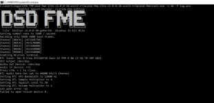

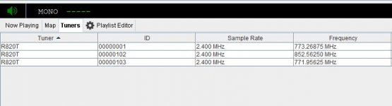

Rebooted computer with nothing else running and tried to start 3 - tail-the-console-log first but it's still having a problem starting rtlsdr device 0. I currently have 3 rtlsdr dongles plugged in and they work fine in SDRTrunk. I changed the serial numbers on 2 of them weeks ago to help differentiate which one was connected to which antenna. Serial number end in 00000001, 00000102, 00000103. If I can get past this issue, I think I'll be good to go.

I did run Zadig to initially install them. I don't know why things have changed now. They do still show up in SDRTrunk under TUNERS with the serial numbers that I changed them to. I just got a 4th Dongle delivered yesterday. The new Black V3 Blog Dongle that I will be needing to install and setup. Maybe I better try and redo them all with Zadig if I can remember how to do that. Thanks
Okay, so, I think others touched on this, but if not mistaken, in Windows, depending on how the Zadig driver was installed (on composite or on the bulk in interface) the rtl device index at 0 isn't available, but the subsequent numbers will be. So, in other words, in the bat file you are using to launch with the rtl string, you will want to change the number from 0 to 1, or 2, or 3 to tell it which device to use. So, in other words, you may want to change the line in the bat file that is launching from:
Code:
dsd-fme-lite.exe -fi -i rtl:0:453.16875M:42:0:12:70:6021 -C AVFD.csv -T -N 2> log.ans
to
Code:
dsd-fme-lite.exe -fi -i rtl:1:453.16875M:42:0:12:70:6021 -C AVFD.csv -T -N 2> log.ans
-i rtl:0:453.16875M:42:0:12:70:6021 <--change that to a 1, or 2, depending on which dongle you wish to use.
