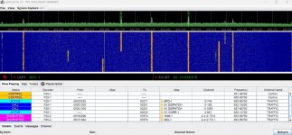

I think this is the screenshot you wanted...the frequencies on that zone run from 854.3375 to 859.7875. Slightly more that 5 mhz (2 1/2 per tuner) so I was wondering about a 3rd one? although I don't appear to be missing voice traffic.)bandicam 2023-04-25 13-41-22-282.jpg

That's the now playing tab. Take a screenshot while in the tuners tab. Take a shot for each dongle.

This screenshot is a hot mess; the later two are what you should be seeing. Noise floor is high.
