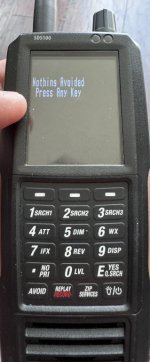

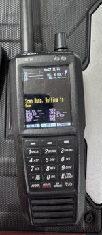

Attempting to program several channels into my SDS 100. Arkansas state police and Arkansas game and fish are doing the same thing. Channels are programmed and all on. I have verified that they are not avoided and that service types are on. However, when I specifically try to select just those favorites, it gives me a “scan mode, nothing to scan”. Pictures for reference. Any help would be appreciated.

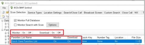

Did you select monitor and download in the profile editor before writing to the radio?

I was merely highlighting where download and monitor setting was.

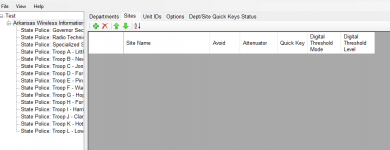

Looking at your file, you have multiple Departments entered, including all of the State Police Troops. But you do not have any of the Sites. For a trunked system, such as ASP, you need to have both the departments you want to monitor, as well as the sites, which carry the actual radio traffic.

The file attached to your earlier post (the one I originally replied to) only had departments for the various state police troops. There were no sites in the *.hpe file you attached.

This is how your original file looks when imported into Sentinel:
All of your entries are Departments. You do not have any sites programmed:
Without Sites, and their associated frequencies, all the programming in the world, using only Departments (and the talkgroups contained in each Department), you will still get "Nothing to Scan", and no transmissions heard.

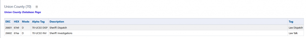

For your county, Union, there are a couple of talkgroups available on AWIN:

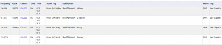

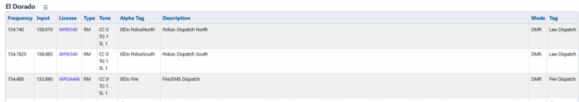

However, it appears that most of the activity, for both the county as well as your city, El Dorado, is handled using their DMR channels:
If you wanted to hear them, you would need the DMR Upgrade (if you do not already have it set up).
