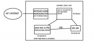

As illustrated in the attached image; my ISP connection enters my house and connects to a Netgear Nighthawk CAX80 in my basement. This modem/router combo has been disabled for any routing capabilities, wifi, and set to bridge mode. I am currently unable to connect to it anywhere on the network by typing in the router's address and can only connect by physically connecting an ethernet cable directly to it in the basement.
Upstairs, in my office, I have an ASUS GT-AX 11000 Pro Tri-band Wifi router, which is the main router for our home. This has ethernet cables, connecting an ASUS Nuc 14 Pro (acting as a home server/ProScan server) and my SDS 200. The SDS 200 is further connected to the NUC via USB cable.
Currently, I can start the web server via ProScan, and connect to it INSIDE my LAN, by navigating a browser window to 192.168.50.174:5000. When attempting to connect to this same open port from outside of my network, the connection is refused. I have used various network monitoring tools, and command line (netstat) prompts to view open/listening ports, and verified that ProScan is indeed listening on port 5000, not just on 127.0.0.0 localhost, but also via 0.0.0.0
My next troubleshooting step was to conduct a deep dive into windows defender on the Asus NUC and verify there was no traffic being restricted on this port, and to add a rule allowing it if so - no problems there. I then connected to my Asus Router and proceeded to verify that port 5000 was being forwarded and not blocked by a router-level firewall - again no issues there. Out of fear that I may have a double NAT connection (either from ISP or the CAX 80 in the basement) I have checked my external WAN IP address through various online tools, making sure there wasn't more than one hop from the same WAN IP I see in ProScan - again, nothing indicating this.
