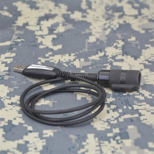

Hey, I have a copy of the PC software for the new 2023 TCA PRC-152, seems to run fine & have worked out how to set it to English mode !
However, I have been informed you need a new version programming cable to use with it, bummer ! No wonder could not get it to communicate with my radio at all... Not cheap either. Anyway, will post a copy of the software for owners of this new version PRC-152.
(Ok, cannot insert the PC Software RAR file, too big ! How do I upload files onto this forum ?).

I think that is the version that I finally got, but my cable did not work either. Do you have the pinout for the new cable?

It seemed like a rush through version as it isn't as polished as the previous releases. I worked with the seller of my cable and then they realized that I had the new version, so they sent me the new software and a different driver and told me it would work. It did not and now they won't answer emails...

herodream888 was the seller of my cable. The Prolific driver that they sent would not work. My PC kept installing a CH340 driver. The seller kept insisting that I was doing something wrong, so I took the cable apart. Go figure, there is a CH340 chipset on the PCB, not a Prolific. Once I sent them pictures of that, they sent the CH341 driver. It still would not work. They asked which version of radio I had and I told them the 2023 version. They then sent the new version of software, which keeps asking me for a password when I attempt to read the radio. The seller says that it should not do that. If I cancel the password or get it wrong, the radio resets. Now the seller won't respond. For all I know, my cable should work, but nobody seems to know what password I should use.

That is the cable that I bought. That password did not work either. It also wants a password to read/write, so you can't just write over the codeplug with a fresh one. I suppose the cable would work if I had that password.

Mmm, almost suspect that cable is for the older radio versions, the software on the PC shown is the older software, definitely not what I have. My software was not asking for any password to read the radio, waited like 10secs, read progress bar not moving, then timed out & said to check the radio connection. Tried a few times with no joy.
VK3TYG
Jun 27, 2023
22
The programming cable needs to specifically state is for the new 2023 model radio, no such mention in this EBay ad.
