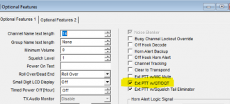

Another thing to look at if you are using the rear PTT. You should have no problem hitting that repeater, he has a ton of RX sites and it is a voted system IIRC.
That is only for PTT output, the issue I am having is receiving! I can PTT out just fine, it's the RX that is the issue.
