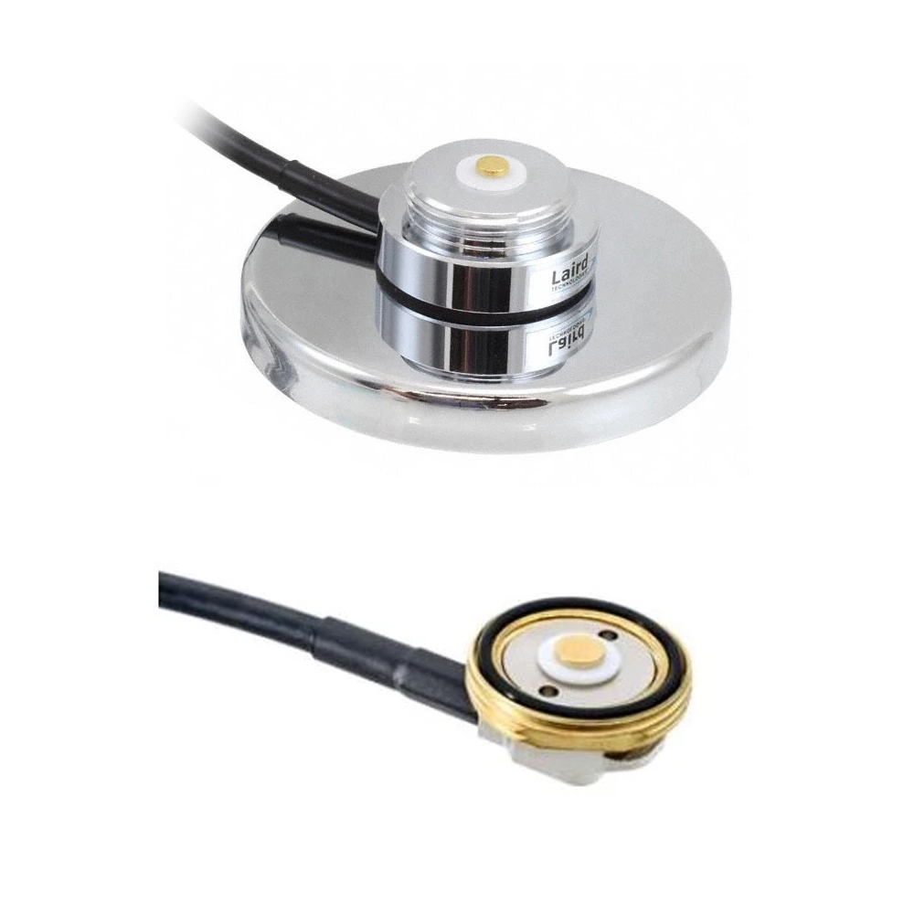

I don't know who makes the Midland antennas. It is probably not Midland, which would mean they are sourcing them from someone else which leaves a lot of questions. And, $30 for an "unknown" manufacturer mount is downright silly. Especially when you can get a known name brand mount for almost half the price:
Here are some Larsen NMO mounts with coax for good prices. eBay is your friend.

Laird mag-mounts have been problematic recently. Even Laird admitted they have had quality control issues and have had a lot of returns on their products. I don't know where they stand today regarding their quality control issues.

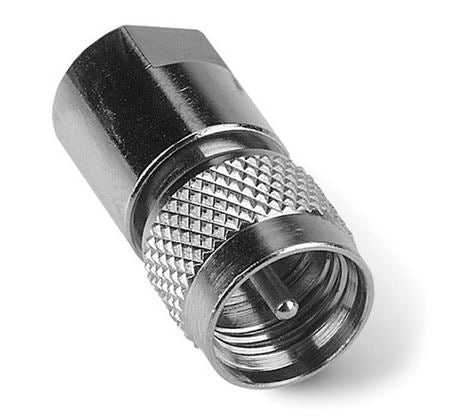

I'm unclear on the connector type on these. Do they have mini-UHF (which I believe is what's on my radio), or FME, or something else I'll need adapters for?

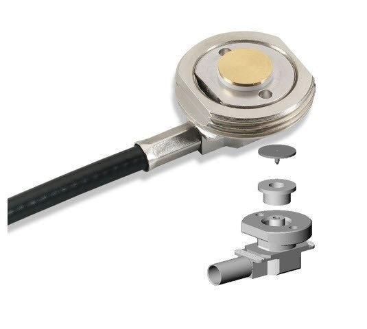

For the mount, I assume this is what I need to connect the FME on the end of the cable to my radio?
That mount has an FME. That allows you to route the cable without cutting the end off, and then just install the adapter you need.
Mini-UHF connectors are rare on anything other than Motorola radios. You need to be 100% of what you are looking for. Post a photo or model of radio, and we'll be happy to assist.
A picture is worth a thousand guesses.

It’s best to route the cable, cut off the excess and install a connector that fits your radio. Or in my case I terminate most of my cables in BNC then use an adapter for some radios and if I only have a handheld with me it’s an easy connection. A BNC to other adapter has virtually no loss below 1GHz.

It looks like it has a UHF/PL259 antenna connection.
Correct, it appears to be, although it does not state that anywhere that I could find on the webpage or the owners manual.
UHF and mini-UHF are different/non-compatible.
The FME connector was rolled out about 20 years ago as a small connector that was easy to route, and then just used an adapter that would fit the radio. The entire connector package (FME + adapter) is fairly short and lightweight, so it doesn't put a lot of extra strain on the connections.
The BNC connector option that prcguy mentioned above would work just fine, but has a slightly larger diameter. Since he's got a jeep, he could probably tell you if the BNC connector will route easily through available paths.
Ideal situation:
You run the bare cable with no connector attached. Then cut the cable to length and add the correct connector for the radio.
Installing coaxial connectors takes a bit of skill, experience and having the right tools. Not a good fit for your first time.

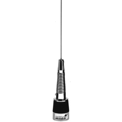

I contacted that site about the EMWave and it's not in stock and would take a few weeks to get from them. So I'm thinking about going with this one instead:
The specs look pretty similar, any reason not to go this direction?

That would work just fine.

I got the antenna installed, but haven't had a chance to test it out yet though. I have a SWR meter being delivered tomorrow, so I'll be tuning it and testing things out in the next few days! For GMRS use, including repeaters, should I shoot for the 465 MHz for tuning purposes?
I noticed the cut chart says 8 9/16" for 465 MHz, which made me realize that the antenna seemed kind of small for a "15 inch", so I measured it and it's about 12 3/4" from the bottom of the base to the very top. I guess they measure antennas the same way they do TVs, or is it possible I got the wrong one?
Yes. Happy medium. The SWR curve is going to be pretty gentle, so there won't be much of a difference between the 462.xxxx and 467.xxxx
It's always possible they sent the wrong one, but double check the packaging and also check to see if there are any marks under the base coil indicating the model number,
However, the cut chart gives the length for the whip only. The spring adds to that, and probably a bit of the base coil.
15 inches would be the length for the lowest designed frequency. At 450MHz, the whip would be 9 5/16th's. Add the length of the coil and the length of the spring, and you're probably pretty close to 15 inches.
