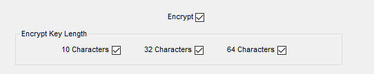

Hi all
For PD 502 and PD 505, am I correct in saying that the 3 encryption tick box options are all 'basic' privacy with either 10, 32 or 64 char length?
So no hope of being compatible with moto or anytone enhanced privacy?
thanks.
