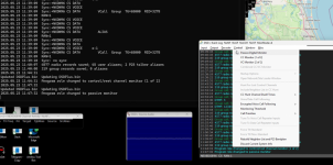

2.523 question
Has the NXDN GPS decoding been removed from DSD+ ?
Trying to work on a few things and I am not seeing the GPS string (usually in teal or dark green) not populating in the data output window.
and not showing in the RAW data window even though I have the radio pulsing every 10 seconds trying to figure out if the code was changed or not.
Thanks

Not changed or removed, did you check the DSDPlus.LRRP folder and see if it is loading/receiving, are you sure the agency is still sending it OTA?

it's my radio(s) and yes, I have I have it turned on.
And I see the GPS data burst on SDSharp, but it is not decoding it, nor when set to auto, and no I don't see it when I am keyed up either.
Use to when I was debugging it for APRS use on the NXDN WW CORE, right now working on getting the nx-5600 working on 6m and Business band for a customer..
November 2024 is the last time it recorded GPS from my radio when doing a test.
