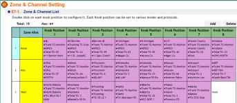

OK here is where I get confused.....I have program opened to "Create new profile" but there are 11 choices! I don't know which one of these is the correct one and I dont yet know the model number of radio. There is an option that says "Search by connected device" the results below were from "Search by condition". So I guess it would make sense to wait for radio, connect it, then click "Search by connected device". (?)
I guess I could eliminate those choices that mention encryption.

I pick the second one:
It's super easy to move data from one profile to another if later you need to.
Please don't underestimate the value of the public resource manager. I just checked, no profile required to do this important foundational work.
Turn off the internet and take a run at this.

I think I understand a little better.....the knob with numbers, 1 ,2 3, etc contain ZONES inside them. I see what you mean....the regular RISCON 800 mhz sites could be in knob position 1, zone 1 and the STATEWIDE 700 site can go in same knob position (1) but in ZONE 2! I kind of miss when they called them BANKS......I was confusing the ZONES in the software and the SITES in a system cause sometimes sites are also called zones. OK if thats the case then I could assign knob position 2 zone 1 for analog police/fire and zone 2 in same knob position for analog HAM freqs......I am just trying to see in my mind how the software lets you set radio up. And also maybe assign knob position 3, zone 1 for DMR HAM.........so I just have to figure out how to actually do this in the software. I watched a bunch of videos but I get sidetracked when they start talking about TONES and VOICE prompts/reminders? I dont need any of that stuff. Not interested in recording...I just want this pager to work like a basic scanner. In many examples, for instance in big towns/cities in midwest, the P25 systems out there are HUGE.....the system in RI is SMALL so it should not be too hard to program the radio. And I wont be using any tones or recording or voice/tone/color alerts......too distracting.
Just remember, it's way easier to switch knob positions than zones. (at least to me). I'd think about keeping the stuff you listen to most in one zone and then use those knob positions and then other zone(s) for perhaps another group.
Obviously in the end it's how you prefer it to be but just a thought. I know you don't have the pager in hand yet, but it's key to know you cannot switch zones while the radio is actively receiving. If you need to do that, (while actively receiving) you'll either need to leave a blank knob position to switch to, or, if the signal isn't too strong you can slightly unscrew the antenna to loose signal to switch zones.
At times it's so busy on my simulcast system, I had problems the way I had it programmed the first time, and ended up leaving a blank knob position so I could switch to that to switch zones if needed.
A zone is a collection of knob positions. Up to 8 knob positions in a zone. I don't know what the the max number of zones is, I have 3.
You really need to launch the software and get started. I think you are suffering from negative learning at this point.
Agreed, get the software going and just have at it. I do not know the max number but I have 8 Zones at this point. I will likely add more later and switch some things around however, after traveling with it using different scanning methods, I want to organize some things by state a little better.
