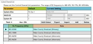

Trying to program the control freq in a unication g5, that's why I wanted it.
You can still enter all seven frequencies in C1 or E2 and the G5 will find it and ignore the others. Just click on the system detail box, then control channel list.
